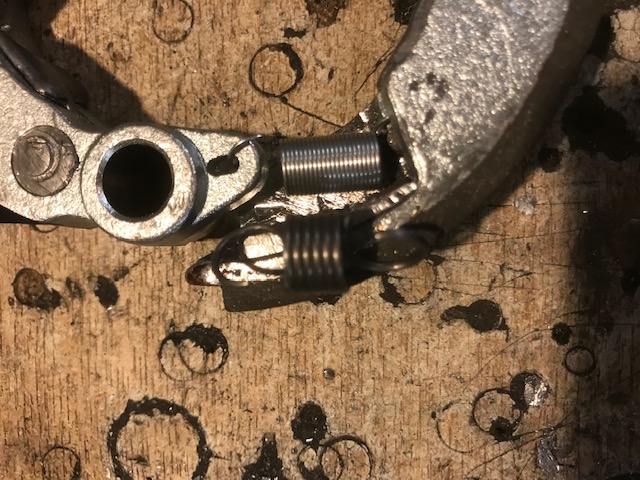

i have fitted some very weak springs 0.5mm wire.
am i going too weak?
ive drilled x 2 and filled with lead
if anything it engages higher?

yes i tried it and if anything it was worse? how is that? its a mobylette 50v 1974 but ive fitted an AV10 motor with a parmakit 50mm top end.
i am gonna try it with no springs, crazy but im running out of ideas. i think because the pulley/c;utch speed is so slow compared to the crankshaft there simply isnt enough centrifugal force for this to work below 7000 rpm.
my only other idea is to get the clutch arms relined so they are within half a mm of the bell. at the moment they are 2.5mm away. or i might slick some friction material to the bell
lol. or sandpaper.
maybe if i tried the er2 clutch arms fastened to the pulley. does the er2 have a lower rpm engagement point?
i see mir5 has replacement arms for the er86 only 16 euros. with thicker lining for better contact....

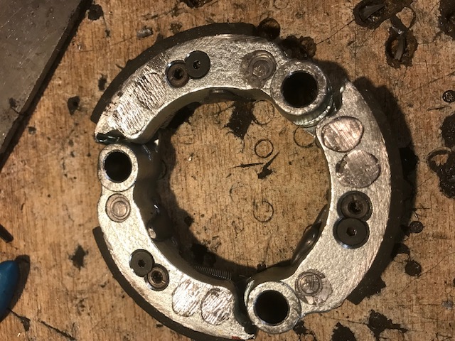

my arms now weigh 170 grams each. i just tried it with NO springs at all. and the engagement point is exactly the same and the bell got very hot to touch.
do i have to run the friction material in? bed it in or break it in? i dont know if this will translate?
something is definitely wrong.

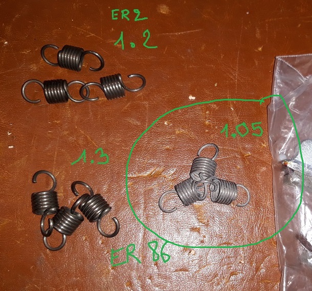

Re: er86 fix
Hi, I didn't understand everything about the translation. If you can add photos it can help to understand each other.
Have you tried with Ø 1.05 mm wire springs?
Salut, j'ai pas tout compris de la traduction. Si tu peux ajouter des photos ça peut aider à se comprendre.
As-tu essayé avec des ressorts en fil de Ø 1.05 mm ?

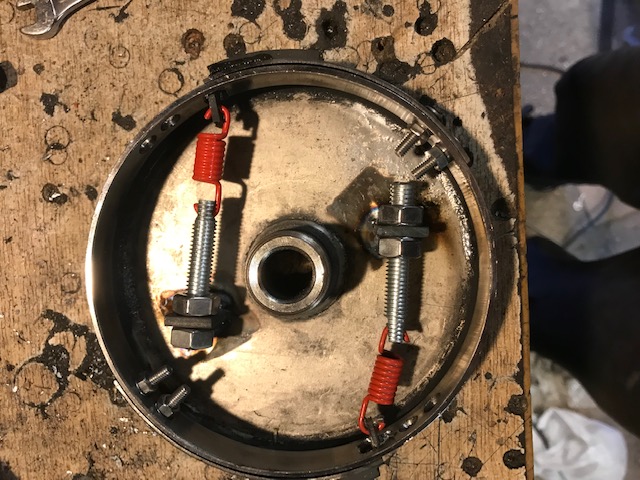

its all free i check that every time.
there was roughly 3 mm difference in bell diameter and diameter of the arms.
i have tried the springs that came with it (the weaker ones that were fitted.) they are 1.15mm ive tried 0.85 wire and 0.5mm wire. no difference.
i think it isnt spinning fast enough. not enough centrifugal force.
i think am going to have to increase the speed by fitting and mounting it on a smaller pulley.

david 76 a écrit : ven. 22 oct. 2021 - 19:31 your arms are free on the axes? I think that you have a mechanical limit which prevents the good support on the bell.
i can move the arms well past the diameter of the bell. there is nothing stopping them moving outwards

maybe i need to run it for a while to get the lining worn to make better contact with the bell.
i will roughen up the bell and the lining and try and be gentle on the throttle for half a day to see if it improves.
maybe my weak springs are too weak?
thank you for all the help and advice so far

And what about the spring preload adjustement?
Also, I've read something about the paint from the bell who can stick on the shoe.
Can you check thib?
https://www.google.com/url?sa=t&source= ... dgxKTU--ww
Re: er86 fix
I looked at the photos again and saw that the lead was poured near the axes?
it won't really change the point of engagement.
to be effective the weight must be added away from the axes and you can't because the springs are inside the arms. the only way to decrease revs is to use softer springs. also check the gaskets and the bell (no oil, grease, paint, etc.)
and like my bro says: what about the sprints pre tensionning system inside each arms? did you tried to change it?
I do not see on the photos if the preload is at the minimum or not.
J'ai regardé à nouveau les photos et j'ai vu que le plomb était versé près des axes ?
cela ne changera pas vraiment le régime d’accroche. pour être efficace, le poids doit être ajouté loin des axes de rotation et ce n’est pas possible car les ressorts sont à l'intérieur des bras.
le seul moyen de diminuer le régime est d'utiliser des ressorts plus souples. vérifier également les garnitures et la cloche (pas d'huile, graisse, peinture, etc.)

got to dash so this is quick.
can you not see the two holes filled with lead near the end of the arms?
preload at minimum and tried several springs from 1.2mm to 0.5mm wire.
going to clean everything and sand down and run for a while.
il faut se précipiter donc c'est rapide.
ne voyez-vous pas les deux trous remplis de plomb près de l'extrémité des bras ?
précharge au minimum et essayé plusieurs ressorts de fil de 1,2 mm à 0,5 mm.
va tout nettoyer et poncer et courir pendant un moment.

indeed, I looked too fast, i saw them but I thought they were foundry marks…
